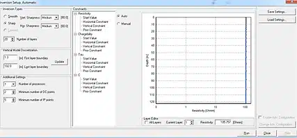

EM Inversion
AarhusInv uses a local 1D model description, with models laterally and spatially constrained to form pseudo-2D and 3D model spaces. The inversion code is designed to handle data from very big airborne EM surveys and supports multiple CPUs. Besides the resistivity models, the inversion code also calculates a depth of investigation value (DOI) and a data residual for each resistivity model. The inversion setups are:
  • LCI-setup: Lateral constraints along flight lines for 2D model space.
  • SCI-setup: The models are laterally constrained along the flight lines and across the flight lines, resulting in a 3D model space.
  • TEM IP: A full Cole-Cole or Maximum Phase Angle inversion is available to model IP effects in the TEM data.
Inversion support
  • Smooth models: The resistivity model is discretized using several layers (~10-30) with fixed layer boundaries. The regularization penalizes vertical changes in resistivity using an L2 norm, resulting in a vertically smooth resistivity model.
  • Blocky models: The resistivity model is discretized using several layers (~10-30) with fixed layer boundaries. The regularization penalizes vertical changes in resistivity using an L1 norm, resulting in a vertically smooth resistivity model.
  • Sharp models: The resistivity model is discretized using several layers (~10-30) with fixed layer boundaries. The regularization penalizes certain sizes of vertical resistivity transitions, resulting in resistivity models with relatively sharp vertical resistivity transitions.
  • Layered models: The resistivity model is characterized by a small number of layers (~4-6). Both layer thickness and resistivity are model parameters.
  • Prior constraints: Customizable for any model parameter, initialized from grids, the GIS map, or specified at borehole locations with decreasing strength moving away from the borehole locations.
  • Depth of investigation (DOI): Derived from the Jacobian matrix for each model, standard and conservative DOI estimates are provided.
